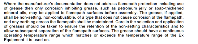

  • Latest Ed 6 of IEC 60079-14 Reg 8.7.3 "Protection of Flamepaths" indicates the following:
    Of course the threaded entry for the cable entry device (Gland), is of course a threaded flamepath so 8.7.3 would apply if wishing to prevent corrosion. If the copper ease was applied by the manufacturer and not the installer, I would ask the manufacturer for written confirmation that the copper ease they applied is actually appropriate.

  • IEC 60079-1 (the constructional standard for Ex d enclosures) gives effectively the same requriements for properties of grease for use on Ex d flanges and other flamepaths as those given in the extract by  from IEC 60079-14 with the addition of:
    '. . . does not contain an evaporating solvent . . .'
    There doesn't appear to be a explicit requirement in either standard relating to the conductivity or non-conductivity of grease, other than the requirement in the IEC 60079-14 extract that:
    ' . . . any earthing across the flamepath shall be maintained.'
