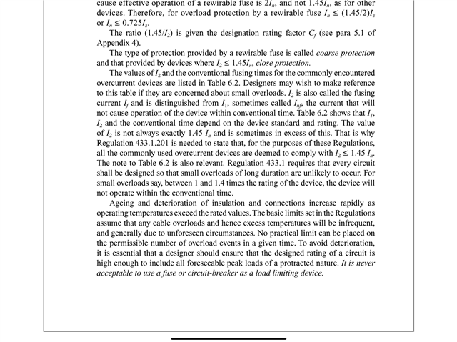

    Agreed but see comment by the eminent Mr Paul Cook (last sentence in italics on this page);
  • It is in my view acceptable to down rate the ocpd for a ring final to 20 amps, provided that the maximum sustained demand is reasonably expected to be 20 amps or less.

  • "It is never acceptable to use a fuse or circuit-breaker as a load limiting device."
    I think that one has to be careful with words like, "never", "always", etc.
    Starting from scratch, it would be poor design, but here we have a potentially dangerous circuit which appears to have been extended without sufficient thought concerning the design. A 20 A MCB may be the least bad option.

  • I think that one has to be careful with words like, "never", "always", etc.
    Well, yes ... we will ever have this problem with socket-outlet circuits. They are never "load limited" and therefore require protection against accidental overload.
    I think, though, there's a difference between the "kitchen sockets" vs the "upstairs sockets" when taking this into account ... clearly one usually has more propensity for accidental overload due to anticipated loads involved.
