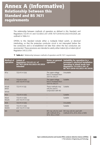

and I am struggling at present to fully understand the implications of IET -01 and its relationship with Bs7671, specifically the regulation stated below.
For a number of reasons, a manufacturer of a device to IET 01 might choose 722.411.4.1 (v).
