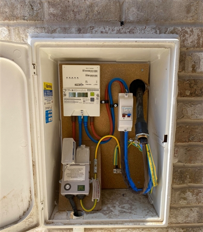

There’s debate about exposed basic insulation in meter cupboards being satisfactory or not? Industry guidance (WRAG) say it’s satisfactory if the door’s in good shape, what’s people views on this ?

Depends what you mean by “meter box”. I doubt anyone would feel comfortable with single insulated cables in this meter location;

The question arises due to the increasing acceptance of terminating SWA cable cores directly into an REC isolator within an external wall-mounted meter box. This practice does not comply with regulations 134.1.1, 526.8, and 521.10.1.
134.1.1 is a vague catch-all which can be interpreted as "if I don't like something, then it doesn't comply".
Why do you think the other two regulations are not complied with?
That's a bit harsh! I think that we can distinguish fine workmanship (craftsmanship), good workmanship, mediocre workmanship, rough as a badger's bottom, and downright dangerous. Problem is defining the boundary between good and mediocre.

I agree with Chris. During elec training, individuals are taught proper installation practices The practice of using a SWA cable with its cores exposed and connected directly into a REC isolator does not align with best practices ( my training to ECS installation technician grade)Additionally, other relevant regulations address the fundamental requirements for insulating exposed basic insulation outside an enclosure.
That's the sticking point though - as soon as someone decides a meter box counts as an "enclosure" (accessible only with a key or tool) - anything goes.

Those REC isolators trouble me. On the face of it, they do the same job as e.g. an Eaton Glasgow switch-fuse-isolator (or just switch-isolator if solid links are fitted), but when you look at the innards, surely they cannot perform the same function!
Yes, Andy, this is the core of the debate. Although WRAG has classified it as an enclosure, I personally disagree with their decision and will continue to treat it differently. Whjohnson, just to clarify, this was meant as a discussion point, not a question.

Does BS 7671 explicitly carry EN 60721 external-influence concepts into Appendix 5? So that utilisation by ordinary persons (BA1) is itself an external influence that must be applied with 416.2.3 to meter cabinets opened by householders in normal service?
Hi S. I’ve given this topic much thought. Yes, BA1 (ordinary, uninstructed persons such as householders) is a utilisation-related external influence. But, Regs 416.2.1 and 416.2.3 focus on preventing access to live parts, not basic insulation
I mentioned earlier in this debate about potential non-compliance with Reg 521.10.1, 526.8 In a meter cabinet opened by BA1 persons, with exposed basic insulation is vulnerable to accidental damage or degradation, potentially leading to live parts becoming exposed over time. While the cabinet may meet IP2X requirements when closed, does it fully address the risks during normal service when householders access it. I think it’s a case of prioritising expediency over safety with the SWA cores exposed install method. I don’t think it can be argued against as it seems to meet 7671 standard.

As I think we have already established, the answer hinges on whether a meter cabinet is an enclosure or not.
Just as a matter of interest, how would people feel about "singles" just sitting there in the meter cabinet? (Obviously excluding G/Y.)

Well, ordinary persons fit the definition. They also include children, who are both at a convenient height for peering into a mater cabinet, and curious.
