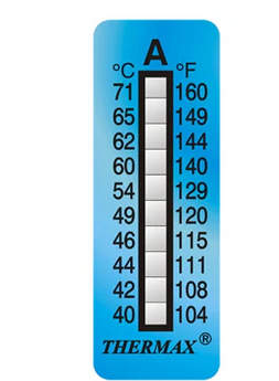

    Peak reading (non-reversible) temperature stickers can be a great friend in a case like this, as they can be put in the tight spots where air flow is restricted and other cables are close, and after a few weeks or months, can be re-inspected.
    Then you have the hard irrefutable evidence you need, to either say "sorry chaps we really must up-size this cable' or 'this is not  ideal but in practice there is no issue' and you are not left guessing if there may be a problem ahead or not.
    The tables of  current ratings for various installation methods in the regs are really only a guide, and are often not quite the same as what you have anyway. They necessarily have to err on the safe side, but as you have the actual installation, you may as well measure it.
    Mike.
    PS
    There are a few makers of things like this - self adhesive and readily available with various nos of steps and step spacing. The grey boxes change colour to a blue/black if that 'high tide' temperature  has been exceeded.
    We sometimes build them into products, so we know if the customer returns it under warranty if they have been reckless and overloaded it in some way, or if it has been looked after, and as our instructions in a well ventilated space and and kept clean etc.
    We often put two side by side one for 'normal operation' - so we see it reached 50C inside, and another for 'you must be joking' that goes to 120C or so.. for those more intense ' you broke it ' type customer discussions.
    Don't carry the low temperature ones in your pocket or leave them on the dashboard in the car on a hot day...
