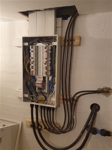

How best to utilise two submains, achieving 10mm CSA for main bonding
I have two 35mm 3 core submains, 70m long, running from a garage to house. on a 63A, C curve MCB. (very big house and grounds)
Armour of each is equivalent to about 9.25mm, just below the 10mm I need for bonding
Supply is 100A 3 phase, with 2 phases going to the house, 3rd to heat a pool.
One submain is going to the main house CU.
I want to take the second submain to a seperate CU for two EV chargers, putting the EV chargers on the main board is likely to take max load over 63A, can't increase the breaker due to voltage drop and I already have voltage drop concerns with the EV chargers. Implementing load management on the EV chargers is challenging because the previous electrician didn't include a data cable in the supply running through a roof and under a path.
To achieve the 10mm minimum CSA for bonding can I connect a 10mm earth between the existing and new EV CU at the house end and then consider the csa of the earth connection to be 9.25 * 2 = 18.5. In my mind it's ok, specially as 9.5 is already very close to the  10mm required?
Anything else I need to think about.

    Both submains run in to the one CU at the moment
    Does that mean that the CU has two isolators? If it has a metal case, the armours are already re-united at the downstream end, which now gives you the 18.5 mm² Cu equivalent CSA.
    I do not see any reason why the armours should not be joined, but I think that would be bonding rather than earthing.

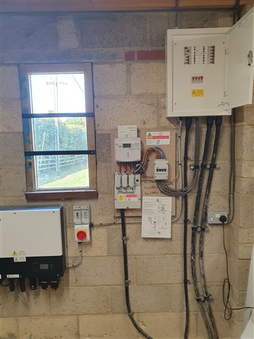

  • Hi Everyone
    I currently have one swa carrying 2 phases and neutral.
    There is a second SWA, 2 cores unused and one core used for earth.
    My plan is to move this second swa to a second DB that I can use to supply a couple of EV chargers, or just extend the cores through to a second DB.
    Combined SWA armouring gives me plenty of CSA for the 10mm bonding requirement and ADS for a 63A MCB.

    The SWA's only use the case of the CU for the armour connection, I will add fly leads to ensure proper earthing and bring them to a common earth bar at both ends.
    As background the third phase is going from the garage to the pool house to power a heat pump for the pool.
  • Above is the dB at the supply head
    This is the house end 2 large swa cables are the submains. You can see one doesn't have all of its cores terminated.
