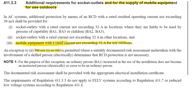

So I've inherited a a mobile installation project. The power cable connection on to External control equipment uses a dedicated port with a MIL-DTL-38999 connector.
The inrush when the charging system is engaged trips the RCD when it is set to 30mA. My predecessor determined that the connection is not classified as a socket and increased the RCD trip current to 300mA.
Given that it uses the 38999 connectors and it is solely dedicated to the dismounted control systems that form part of the system is this a valid assessment?

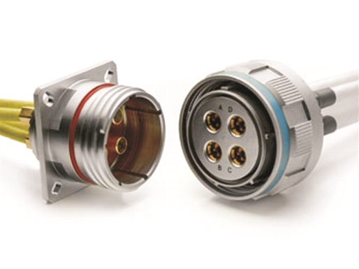

    Note that some of the 38999 socket patterns are have contacts you can touch with a finger  exposed at the mating face - while others are deeply recessed and meet clearance requirements.
    Here is a catalogue page showing just  a few and a photo that illustrates the point.

    The connector is a series 3 connector and is designed so that the pins cannot be touched accidentally and for extreme weather conditions.
     It connects on the front of one of the installations  power system units to provide power to the control systems that have to be dismounted a given distance away for safety reasons. So when you look at the system as a whole it is one system. Frustratingly I think we fall into a grey area when it comes to classifying it as a socket or part of the installation.
  • If you mean BS7671, then sockets that are part of the fixed wiring installation that supply mobile equipment have to be RCD protected.  But I am presuming this whole rig does not connect to the mains that way ? Can you say if it has a built in generator - and so is powered while mobile, and not just when parked up.
    Those 'wiring' regs do not generally apply to any sockets that are part of the equipment itself - that would probably fall under the machinery directive instead, unless we are looking at 13A sockets in a caravan or a Portakabin type thing , when it is sort of a fixed installation for use by ordinary folk again.
    A 30mA instant RCD may not work but if it is really just an inrush issue, then a delay type of programmable earth fault relay example  operating a contactor in the supply might, and still afford adequate and regs compliant protection, as you can meet the 30mA requirement safety of life thing with up to a 0.2 second delay ( or 0.4 secs in some cases)

    As much as I would prefer the belt and braces approach of a 30mA limit, the added complication of the current transformer windings reducing the set trip current to just under half makes it difficult to ascertain if an actual trip current of 30mA would cope with the inrush currents.
    The adjustable RCD has detents at 0.03, 0.1, 0.3, 0.5..... so we can test at 100mA which will give a trip current of around 45mA. I don't know if this was done at the Dev stage because there are no notes of any kind. When I spoke to my predecessor about it, it was 7 years after the fact so the details were a bit, shall we say murky.
