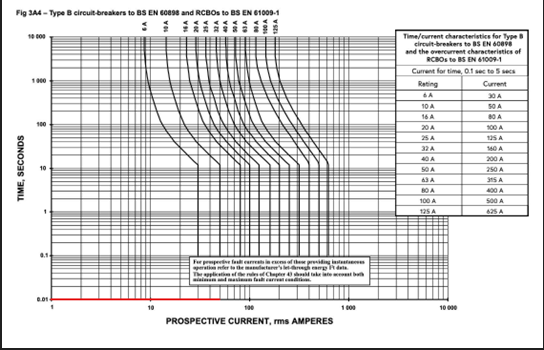

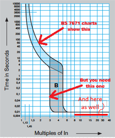

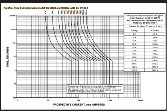

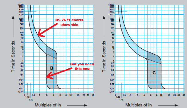

  • Beware of the BS 7671 charts/tables - they're designed to be helpful when you're arranging things to ensure reliable disconnection (e.g. for ADS) - e.g. for B type MCBs they only show the 5x side of the "envelope". To ensure things reliably don't trip you need the lower edge of the envelope (e.g. 3x for B-types) instead .. which gives you rather smaller results.
    e.g. From one manufacturer (there's just one curve for all rating of MCB, as the currents have all been divided by the rating, In):
    That said, as Mike suggested, it's not so much the maximum size of the current pulse that counts, so much as its average up to the point the MCB might de-latch (which can be significantly before the device actually opens - as moving contacts takes time).
