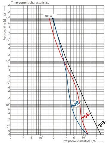

    Struggling to visualize the problem and feeling in need of a quick refresher, I've just had a quick look at the Eton fuse FAQ (https://www.eaton.com/content/dam/eaton/products/electrical-circuit-protection/fuses/bussmann-series-high-speed-fuses/bus-ele-an-10507-hsf.pdf )
    Ignore my earlier response.
    I now have the below graphical understanding  of the issue, and why the gG general fuse is often seen on the drawings paired with a similar rated aR one - the general fuse "fills in the gap" for modest overloads of longer durations. Something new learnt every day.
    There used to be so called 'semiconductor' fuses back in the last century that were not made of semiconductor, but were designed to protect transistors and similar, that also had very fast energy limiting breaking responses but like the Ar were also pretty useless at 'close' protection.

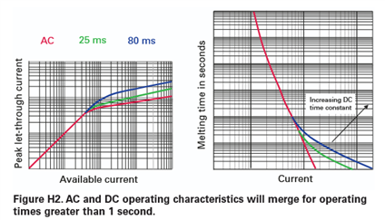

    The other complication is that with DC, when you dont have zero-crossings the arc tends to persist longer, especially with inductive loads.
    I suspect that the designers of the kit might have failed to realise there was more to it than at first appears.
    I think an additional slower blow, but closer protection fuse may be in order to ensure all gaps are filled. It's not quite the same as the unfused spur case.
    Mike.
