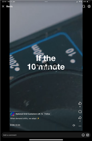

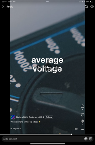

  • I had not realised that there is a ten minute grace period with the recorded voltage averaged over that period.
    fb.watch/.../
