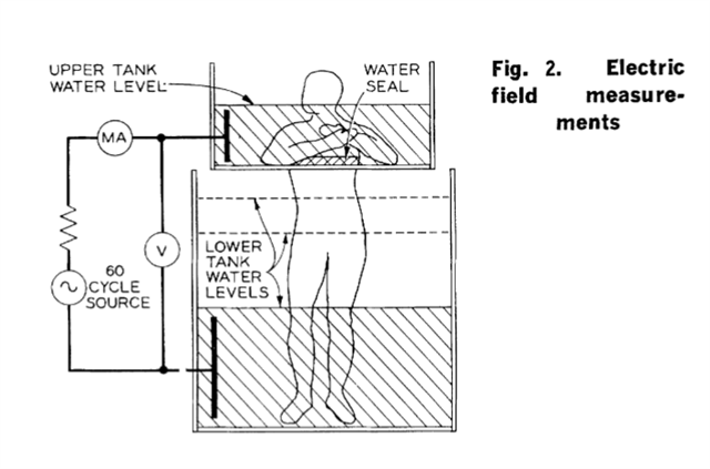

    This 1960s article (https://ieeexplore.ieee.org/abstract/document/4766095 ) mainly looking at shocks from swimming pool lights suggests that the human body resistance drops to of order  some hundred ohms when immersed and significantly less than one volt RMS was needed between the electrodes to get the upper limit they tested of 5mA  flowing in the rather contrived twin tanks test below, down to about 0.3 volts in the case of the most conductive subject and the highest water level, and up to 0.67volts on the most resistive and lowest water level.
