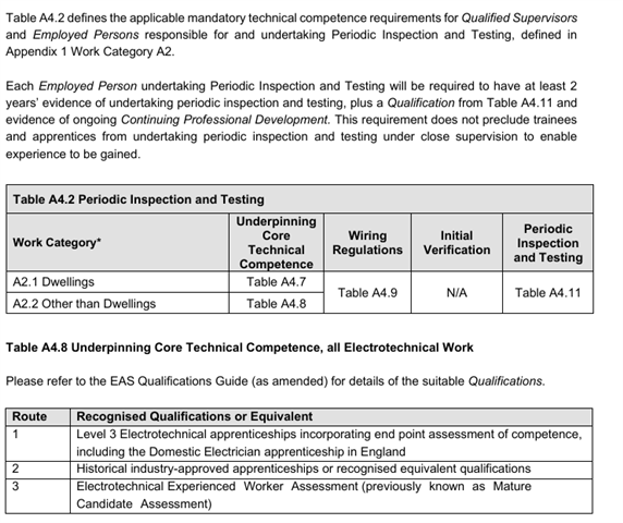

How would you interpret the EAS 2024 requirements for persons employed to carry out periodic inspections in installations other than dwellings where the contractor is NICEIC or NAPIT approved. As I read it, they will need a underpinning core technical competence qualification identified in Table 4.8, that is a NVQ L3 or equal. Not unreasonably, additional requirements include 18th Edition and L3 in periodic inspection and testing. However, if my interpretation is correct, the requirement for a L3 NVQ would be a big issue.
  • I would think you need the level 3 and it says endpoint assessment which I would think means the am2, I also think you won't be able to take a 2391 or most other training without am2
