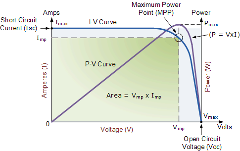

    Realize that the mppt alters its 'transformation ratio' (I know its DC and it is a lot of  switched mode cleverness, but this is a simplified explanation) to try to set the input impedance to try and get the highest voltage before the current falls away , so is always settles at about 80-90% of open circuit voltage and about  70-80% of short circuit current.

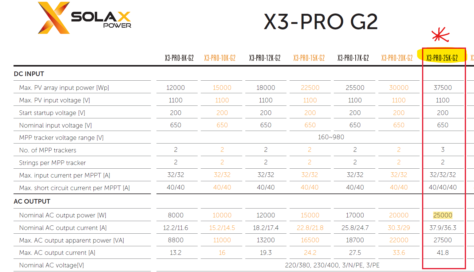

    Here is the inverter
    Today I had to call their technical department and they told me that
    1. All 3 MPPTs are INDEPENDENT from one another
    2. The 2 strings of each MPPT are connected internally IN PARALLEL so they told me I have to have EXACTLY same number of PV panels per string
    3. Total Amps per MPPT is 32A so each of the 2 strings should be max 16A
    What I did not understand was what would happen in case one string is 10 panels and the other string of the same MPPT is 11 panels.
    That means you parallel to slightly different volltages
    When I asked the question he told me something like
    "It will peak the lesser string that is the 10 panel one"
    but when I asked what he meant his accent did not help much to understand more

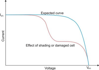

    that is because that the mmpt will settle to a voltage where the there is a shoulder in the I/V curve- and when 2 unequal strings are in pseudo-parallel that shoulder will usually be the lower voltage one, as the way to find that optimum is to  slowly reduce the current, monitoring the voltage rise, and then voltage rate of rise slows even though the current is still falling at the same rate, that is the shoulder...
    Did my explanation earlier in the thread which basically says the same help make sense ?
    If not I can have another go....
    Mike.
    An example of a stepped IV curve when one of the 2 strings is a panel short would look a bit like this orange curve - at the lower voltage both strings add to the  higher total current, but the other  knee is one string only. Here an operating point near the lower voltage higher current knee has the larger total area (total power) unless the other  string is a lot less, but ideally something closer to the blue curve is desired by having both strings with a voltage knee in a similar place.
