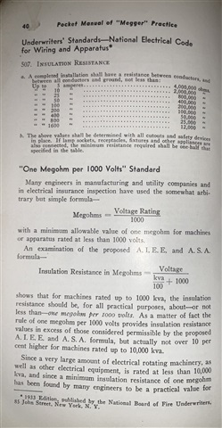

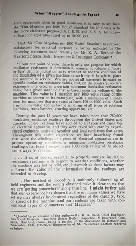

  • The one megohm minimum value is longstanding, it is discussed in my copy of The Pocket Manual of “Megger” Practice published in America by the James G. Biddle Company in 1935, though during the last ninety years we went through a period when two Megohms was recommended.
    A little Friday evening light reading:
  • However, my copy of of the Megger “A pocket book on insulation testing” published June 1946 gives a different method of determining the insulation test value requirements for house installations to meet the IET Wiring Regulations requirements.
    The current expectation given in the IET GN3 is that a new installation will have a test result value of not less than 20 megohms, bearing in mind we have better insulation on conductors and in equipment, plus modern testers can measure higher values, my Megger MIT420/2 provides measurements up to 200GΩ where as those old hand cranked Meggers  measured to 10000 Megohms, with higher values being described as “Infinity”.

  • Thank you for those interesting documents.
    I suspect that 1MΩ was the limit of reliable measurement with your Megger in those days. My Avometer 8 runs out of scale at 2 MΩ, though granted not at 250+ V.
