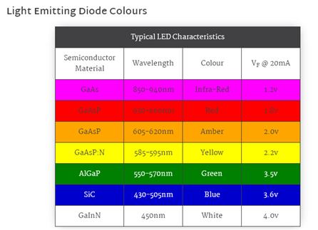

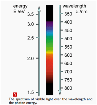

  • Indeed - the individual LED chips drop a voltage proportional to the shortest wavelength (highest energy photons) they emit. So for deep red LEDs, say something like 650nm, require about 1.75V  to generate the photons plus another about quarter to half a volt to get a sensible current flowing in the resistance of the 'ohmic contacts' between the metal and the semiconductor. The substrate itself is a cunningly formulated semiconductor chosen to encourage the electrons to drop down a gradient of just the right voltage for the desired colour.
    However, that is not the full story, to make a white LED needs more like 3V per chip as there either has to be blue, in the RGB 3 colour types, or some designs (with a yellow over-coating) function more like the old florry tube, in that the LED generates a hard blue-purple to soft UV light, that is used to excite a phosphor coating that then emits a broader 'warm white' spectrum.
