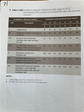

  • A key part of understanding is being able to decide if the information you are basing your decision on is correct, such as here in the IET On-Site Guide.
  • The printed books need checking as well as the information gathered by AI, because there are counterfeit IET books that have errors and mistakes in them.
