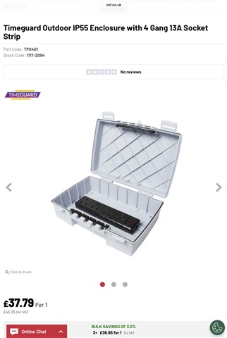

  • https://www.cef.co.uk/catalogue/products/1698557-outdoor-ip55-power-enclosure-with-4-gang-13a-socket-strip
    I have an image in my head of a plastic box on a house wall with a multi gang socket strip supplied from an existing socket outlet and a EV granny charger plugged into the socket strip along with one or more balcony PV sets.
  • well, someone is bound to try it - and I'm not sure that it will be anymore dangerous than plugging in a flymo and using it, it is just that we are used to a very safe electrical approach, and rowing back on that is uncomfortable. I suggest its not much more risky than EV charging from PME, or many other things we do not worry about.
