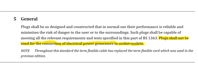

    The obvious difficulty with this idea is the plug and socket. Would you want a BS 1363 plug with 230 V between the pins?
  • a BS 1363 plug with 230 V between the pins
    When its plugged in of course, that's normal and fine from a touch perspective, but if it adds significantly to the available current on the load side of a 32A MCB, now you have all your other loads plugged in to what is effectively a higher rated circuit than originally, but more importantly quite likely with a longer disconnection time
    I'm assuming like the hard wired units, the inverter has to curl up and stop if it detects a total loss of mains, but this may not be as fast as the supply RCD tripping on its own would have been.
    I can see the attraction, and as a plug in gadget, its strictly  outside the reach of BS7671, but I agree there is scope for a few unpleasant unintended consequences.

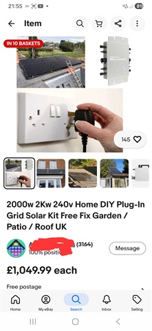

    DIY plug-in kits are  already on sale so I am not too sure what the govt is planning to change or why it thinks it has any levers to control this, as I see it, what folk hang out of a window and plug in is pretty much unenforceable.

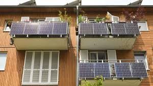

    And in the UK very few buildings have balconies, unless perhaps its a tower block, which is the very sort of place it would not be a good idea to have too much of it as all the problems of reversal of street main voltage drop and voltage rise still apply,

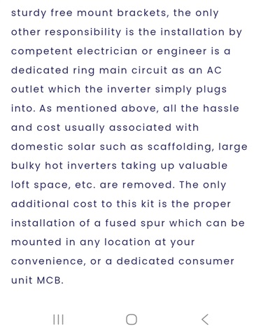

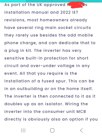

    The better ones do claim to comply example. "With the user-friendly Flex-S3 Plug and Play Cable, installation is simple—just connect the micro-inverter directly to a socket with no need for complicated wiring."
    That particular model can be bought as a kit with a couple of  panels and mountings for a few hundred quid.

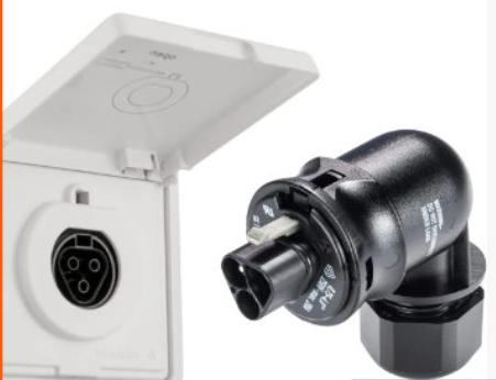

    A commando style socket with recessed connectors would be better then a BS 1363 plug.  There are also the other factors to consider like if this is a DIY job will some of the following be checked first (Not an exhaustive list)

  • An interesting debate so far. It cannot be beyond the wit of man to design a plug and socket arrangement which prevents contact from live conductors on both sides, either purely mechanically, or by having an interlock which opens only when the inverter has powered down.
    Of course, if they really are intended for balconies, it assumes that there is a socket on the balcony. Failing that, do you trail the cable in through a door, which being ajar, lets all the warm air out and defeats the purpose? Not today, thank you very much!
    Now then, do you need to get a pass on an EICR before an MCS contractor will fit solar PV? If not, how do they ensure that the installation is fit to take PV?
    The one thing which seems obvious is that these 'balcony' systems are easier than conventional roof systems. Although a limit of 800 W may not be much, it could be a significant proportion of a small flat's consumption and I like the idea that a tenant can take the system with them on moving house.
    Leaving aside safety issues, what do you do when you want to sit out on your balcony? Fold them away? Their use must be limited on east and west sides of a building where they will be in shade most of the time, and no use at all on the north side.
  • BS 7671 does not concern itself with product standards for equipment that may be plugged in to socket outlets.
    If the government ae so keen on these devices no doubt they will commission a product standard for devices being placed on the UK market that protects the public, livestock and property.
    I do not believe that currently there is a product standard for these devices?
