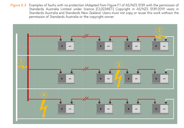

    I think the logic holds for unearthed batteries though.. .you could choose effectively whether you are using the white or red as the 'reference' and all interlinks use the other colour ... example below from the IET Electrician's Guide to Domestic Electrical Energy Storage Systems:

    I know you are experimenting and managing this arrangement,   , and will be aware of the hazards, but just for others who might read the thread without experience in battery systems, there are dangers involved in stringing batteries together like this, rather than using links that are as short as possible (and preferably not flexible).

    Indeed - and it's proving to be a case of the least worst arrangement in the face of what feels like a lot of contradictory demands! Short solid links were indeed considered - but there are a few demands that mean the batteries would need to be disconnected occasionally. The battery manufacturers recommend a 6-monthly "equalization" procedure whereby the batteries are each charged individually and then left connected in parallel for 24h or so. Also the weight of the system is likely to mean that while I can move it about over flat-ish ground by its own wheels (wheelbarrow style) OK, if I ever needed to lift it into a vehicle or move it up steps or anything like that, it would be useful to be able to reduce the weight - so removing the batteries is a helpful option. Even with care, metal tools on bare battery terminals is going to be a significant risk - no less so out in the field, so insulated cables, insulating terminal covers and Anderson connectors seemed a least worst approach. The cables are completely oversheathed with heatshrink to provide some approximation to double/reinforced insulations and the each of the batteries has an an-built BMS which should in theory provide short circuit protection as well (although how reliably given the electronics involved seems up for debate still). Hopefully with 4 in series, the chances of all 4 BMS failing simultaneously is smaller. Don't get me started on the lack of data for things like short circuit currents for these types of batteries, the fact that most "auto" type fuses are probably entirely inadequate for breaking anything like the currents involved or that d.c. data for the better fuses seems to be have filed somewhere alongside hen's teeth (the retailer tells me the supplier say the manufacturer has OK'd the fuse for d.c. use within certain parameters, but the actual data sheets and the markings on the fuse itself say nothing other than for a.c..)

    In EVs  where series parallel strings are common, the general approach is to allow the battery bank to be dismantled into safe to handle pieces with shrouded or otherwise protected contacts, and not to worry too much about fuses in the middle of the chains.

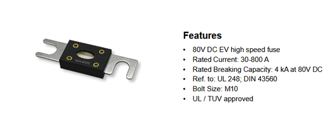

    For your sort of sub 100V Lithium application, these sort of bolt in things may be about right
    https://www.farnell.com/datasheets/4494707.pdf
    or perhaps https://www.farnell.com/datasheets/3860556.pdf

  • Thanks Mike- that Farnell one does seem to be higher spec'd than most.
    PV types typically don't come in high enough ratings (125A recommended by the inverter manufacturer).
    I did plump for a NH00 type in the end (https://www.bimblesolar.com/extras/dc-breakers-fuses/dc-fuse-disconnect/125A-DC-Fuse-NH00) and while the carrier can double as as a disconnector, it's it  bit bulky overall.
