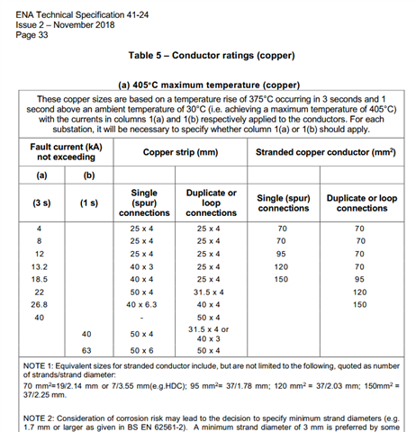

  • Mean while, although no figures  for hot bare copper, are in the wiring regs BS7671 it is interesting to look at the figures the ENA use for DNO type wiring at substations.
    Bare strips and bare stranded wire can be  used for earth bond interconnections to electrodes and between enclosures & so on.
      This table suggests that the  (smallest )bare copper 70mm2 cable is good for at least 8000  amp faults  for 3 seconds, but there is no insulation to damage. Note that at the end of the 3 seconds, the copper is at 405C - a temperature that would be put any kind of plastic insulation beyond use. The same document recommends no more than   325C for aluminium cored wire, and 400C for galvanized steel parts and a 250C rise for exposed bolted contacts however,...
    These are far higher fault current ratings than 'normal' can only be safely used when there is no part in contact that would be damaged by the heat. In a controlled location like a substation this is practical , as only competent persons are installing things, and the dangerous bits are in a locked compound or box, but even so if it were much hotter it would  leave scope to set fire to leaves, dust  or cobwebs, and as it is there are considerations of thermal expansion and stress on joints - hence the reduced limit on bolted connections  !.
    ref https://www.ena-eng.org/ENA-Docs/D0C3D1R/TS_41-24_181106101835.pdf
    regards Mike

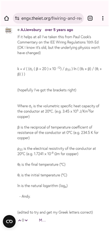

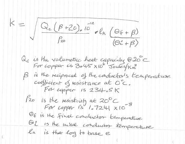

  • I'm still studying about the adiabatic equation and in so doing I've learned a bit more about the way the K factors which appear in the regs have been calculated. This is a level of detail a bit removed from my original query but is all adding to my understanding.

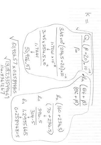

    I found an old entry of yours (screenshot) giving the formula used. I wrote this out on two sheets of paper (attached) and sure enough it works. I used the case of thermoplastic pvc rising from 70 to 160 degrees, k=115
    I'm still studying just to satisfy my technical curiosity but for the moment the derivation of the formula and some of the parameters used (e.g. the reciprocal of the temperature coefficient) is beyond my existing knowledge of the physics.

  • Sorry forgot to rotate the scan
  • How nice to see some proper scribbling! :-)
  • Indeed.
