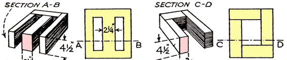

    To estimate open circuit voltage at core saturation look at the magnetic cross section of that sort of core (Am ~ a couple of cm2 at most ). In a none uniform core this  is the point the magnetic field lines all neck down, so the centre leg in a traditional EI core shape, and is where saturation occurs first.
      and assuming a core Bsat of 1Tesla  at  50Hz dB/dt when peak B is +/- 1Tesla is ~ 300 tesla per second. But as above here A is only 2/10000 of a square metre, so the volt per turn at saturation is about 600/10000 or 60mV (if you prefer about 15 turns per volt. TPV)
    Note we don't normally saturate cores, and for conventional (voltage )transformers at 50Hz, when  run backed down from saturation to get sensible core losses, another 'rule of 16' for those who like them, a transformer steel core minimum magnetic area of 16mm by 16 mm is about right for 16 turns per volt..
    In any case at say the high end of a real CT of that small core style is 15 TPV with 2000 turns the unloaded saturation OC voltage implies <~ 120V max.
    This contrasts sharply with  far bigger dangers from  bus mounted CTs with far larger cores (square inch sort of cross sections to go round bigger conductors, so lower TPV, or higher VPT! but also more seriously with greater turns ratios, to bring primary side kA down to something sensible on the secondary).
    If operated unloaded these larger cores can generate many hundreds of volts, and in some cases, as well as having scope for killing an unskilled operator, can actually break down the insulation at the terminals and support some impressive arcing.  (while doing so, also dropping that fraction of a volt as one "turn" winding on the bus-bar.)

    PS
     Areas shaded pink are the limiting core areas in these designs. Ignore the ancient 'inch' notation. Unless you want to memorize  8 turns per volt per 1 inch square core area for 50Hz  transformer steels instead....
