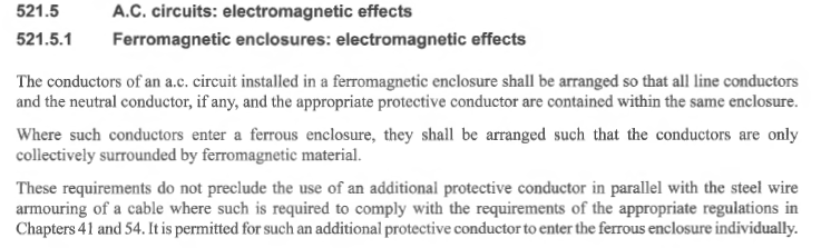

Hi All,
Looking for a bit of a sanity check here!
I have reviewed an installation on site and found a number of circuits with multicore cables in parallel which are glanded into steel gland plates with no slot between the glands. I have raised this as an issue and the contractor is pushing back suggesting the problem only occurs with single cables in parallel and not multicore cables.
I have suggested the installation does not comply with 521.5.1, your comments would be welcome to confirm my sanity!
Thanks
  • I do not believe that eddy currents will be significant with multi core cables in parallel. If the cores of each cable are carrying balanced loads, there will be no eddy currents.
    In practice a slight imbalance is inevitable but I would expect the effect of this this to be negligible
  • balanced load are not guaranteed apart from supplies to some of the mechanical equipment, the question is whether the installation is compliant with BS7671 particularly the concern of all circuit conductors being collectively surrounded by ferrous material i.e. through a single aperture?
  • Problems can occur with multicore cables, but only if there's an imbalance in the "going" and "return" currents in each cable. Normally such arrangements aren't permitted (521.8.1) and where cables are used in parallel things should be arranged so that there's a more-of-less equal division of currents - so again there should be a pretty good balance within each cable. I can see there may still be some small imbalance in practice - but as long as the imbalance is relatively small (<100A say) and we're talking thin steel sheet enclosures rather than 1/2" cast iron, the result is likely negligible (there is a suggestion that the whole 521.5.1 regulation can be safely ignored for DB where the imblance per hole is <100A (from memory).
  • Thanks for the responses, the concerns are that inbalance could be greater than 100A as we have supplies feeding 800A rising bus bar systems in science labs to be used during a later fit out. the problem would be solved by installing a slot. And if 521.5 were to be ignored this would need to be recorded as a deviation from BS7671 sanctioned by the designer?
  • Let's make sure that we understand the situation. As I read it, you have two (or more) cables in parallel serving one circuit. Presumably, the cables run together and are the same length.
    How does any imbalance occur?
    ETA: I take it that each cable has 3 lines, possibly a neutral, and a CPC.
  • correct, cables up to 240mm 4c (L1, L2, L3, N) SWA's feeding panel boards or rising bus bar systems with circuit protection rated up to 800A. the three phases are not balanced, I can guarantee they won't be balanced apart from the parallel cables feeding chillers which are 3c (L1, L2, L3) 240mm SWA's. It is possible that the rising bus bars could feed single phase boards in the future, even if they were three phase boards they wouldn't necessarily be balanced.
    The question really is a BS7671 compliance question.
  • the three phases are not balanced
    That does not matter because the imbalance will be going the other way in the neutral. So if you have two 240 mm² cables in parallel, half of the current in all four conductors will go in each cable (subject to minor differences in the impedance of the cores) and each cable will be balanced overall.
    If the chillers are powered by 3-phase motors and there is nothing else fed by the circuit(s), they do not need a neutral, but otherwise the neutral is there to return the imbalance to the transformer.
    Does this help?
    I would hope that there was something very very wrong if two cables in parallel were supplying 800A and there was a 100A imbalance within each cable. Its not the balancing between phases that's the issue - on a 4-wire circuit any differences between L1/L2/L3 would be carried by N in the same cable - so still balanced overall as far as the cable is concerned.
    The problem arises because the current might not divide equally between the two cables - and even then that's not a problem if the L and N currents divide in the same way in each cable. Using single phase number just for the sake of simplicity, if one cable carried 350A in both L & N and the other 450A in both L & N there still wouldn't be any imbalance overall in each cable - you'd need a situation where one cable was carrying 350A in L and 450A in N while the other cable carried 450A in L and 350A in N - which would need a very very peculiar set of circumstances given the normal rules for parallel cables (same c.s.a., length etc.) not to mention the physical natural tendency for conductor in parallel to self-balance (if one conductor handles more current than the other it runs warmer, increasing its resistance, so increasing the bias for more current to take the other conductor).
  • It rather depends how those multiple cores are wired. If for example  there are loads wired between say the L1 of cable 1 and any other phase or N of say cable 3 then you do fall foul of the '7671 advice exactly as much as you would if they were singles doing the same thing. If however all the 3 phases and neutral of any given sub-main, are co-located in the same cable, they are already passing through the same hole, and the magnetic effects are cancelling. If they are not, and wiring cannot be re-arranged to achieve this, then the hole needs to be made common to both cables by breaking the magnetic loop that surrounds any un-cancelled current. To do that the fastest cheapest way is a slot, to make a dumbell / dog bone shape, and then backfill with braze metal and grind level, or epoxy (HY60 or at a push Araldite rapid ?) and flushtop,  or leave it open to acquire a mixture of fluff and iron filings, depending on the installation quality and location of the offending panel... can you tell I'm not a fan of open slots?  Outdoors it tends to be leaves and bits of bird nest.
    If at any downstream point for example, the neutrals of two cables in different holes were exchanged or even combined, then there is scope for that out of balance trouble ..
    Mike
    That sounds rather like a borrowed neutral to me.
    As I understand it, there are two (or more) identical cables in parallel, so each takes half the current of the combined conductor. Let's draw 100 A in L1, 200 A in L2, and 300 A in L3. Because of the imbalance, you get about -173 A in N. So now we have 50 A, 100 A, 150 A, and -86 A in the conductors of each cable. That still leaves each cable balanced, so the arrangement is compliant.
