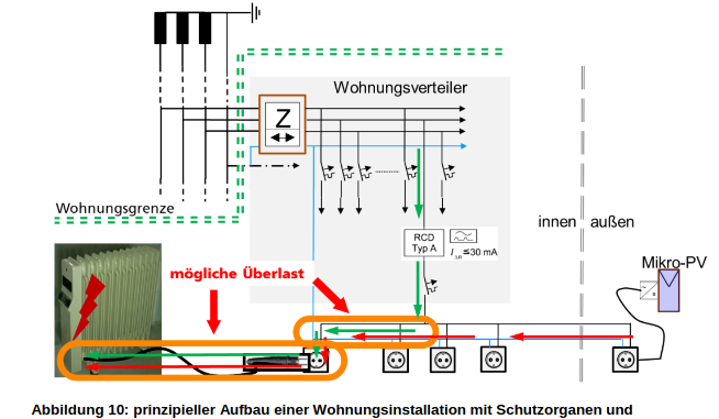

If they are like the German systems, they will be limited to 800W unless wired through a special plug.

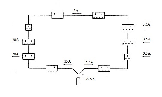

If 3 1/2A is enough to overload a ring, there's something seriously wrong already. In some cases, it could even reduce an overload.

I see it as being similar to PV feeding into a 100 A CU - the load in the busbar depends upon where the PV is connected.
So the ring is protected by a 32 A MCB through which 32 A could flow. An additional 3.5 A could bypass that, but I would hardly call a 9% overload "massive".
Only one balcony system is permitted in Germany, so nobody would plug in three of them.
How often do we have Iz within 3.5A (800W) of In (or 0.67 In for rings)? In Germany I guess they'd typically have 2.5mm² on a 16A radial for their sockets - so even method B there'd be about 7A spare - so even two units would be OK.
Our rings (requiring 20A per leg) would be a bit tighter - method B would only have 3A spare - but then it's likely the currents would be shared - so 3.5A split 3A one way and 0.5A the other would still be OK. Method A wouldn't have a margin of course.
Compared to the risk of someone plugging in a couple of 3kW fan heaters on the same side of the house when the CH packs in, the dangers seem limited.
In practice ring finals are almost never subject to sustained overloads and adding a local plug-in PV system isn't going to increase demand (if anything it can reduce it locally), so if it wasn't going to be overloaded before, it won't be after.
