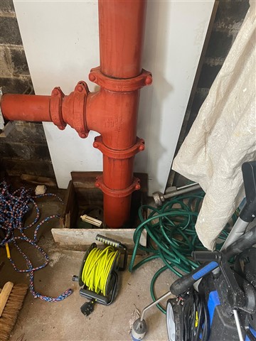

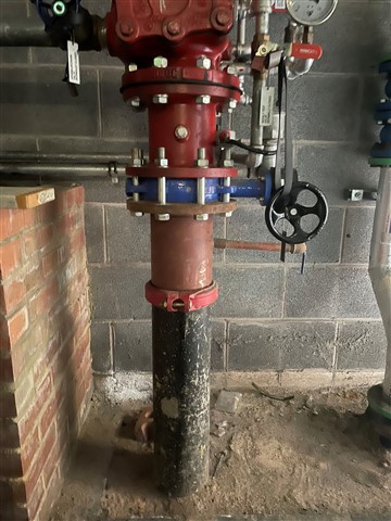

  • Thanks for the reply I have been to site and took some photos.
    I tend to think it should be classed as an extraneous conductive part the same as the water and gas pipework,and therefore bonded where it exits the pump house into the ground and where it enters the plant room in the main building from the ground.
    Image 1 - Sprinkler Pipework Entering Plant Room (Main Building)
    Image 2 - Adjacent Water & Gas Supply Pipework With Main Protective Bonding
    Image 3 - Sprinkler Pipework Exiting Sprinkler Pump House
  • Unless it's just dipping through a slab into a 'services basement' type corridor, this is what I see from those pictures:
    Regardless of whether it's one building or two, it's definitely looking like an extraneous-conductive-part, as:
    • it's not part of the electrical installation,
    • it appears conductive (looks like steel pipes to me), and
    • it's introducing earth potential.
    Even if it's all in the same building, it goes into the ground (and is in contact with the ground, and back out again.
    If it's one building, depending in circumstances, there might be an argument for bonding it once only ... although because sections could be replaced with plastic, I'd err on the side of caution and bond it on each entry to the building.
    If it's two separate buildings, bonding needs to be applied separately in each building to meet the requirements of BS 7671 since 17th Edition BS 7671:2008.
