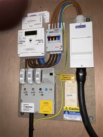

yuk! unbalanced neutral current by design. And no lower covers fitted over the rubber trouser sleeves.
I presume that's pilc with a newer head ?
If so TNS but treat as pme ;-)
Again no lower cover
Naughty, especially on an older cable, as those rubber trouser sleeves only afford a soft single insulation over the stripped part of the live ends.
I'm pretty sure I've seen 3-phase installations fed by three single core concentric overheads - so such things might not be too far from the norm in DNO land. I presume the incoming cables are modern concentrics with copper rather than steel "armour" - so no induced currents to worry about and the line conductors will have their own insulation underneath the trouser boot, so insulation+sheath overall. DNO's don't regard Ns as hazardous. Assuming the two supplies are on different phases the (and not too many nasty harmonics in the load) then the N current shouldn't exceed that of one phase, so no overloading issues. I might have preferred to see both cables run much closer together from an EMI perspective and perhaps the two N linked, just as a nicety and reduce N v.d. a bit.

If both phase are say loaded to 100A, then the neutral is - 100A, yes, as the missing third phase would sum to zero, and this is a worst case, but its horrible from an EMC point of view or for 3rd harmonics, and at any point those cables may go through a metal hole. Not to mention the massive extra magnetic field, some associated extra volt drop, and probably not great for loop hearing aids either.

It’s not three-phase, but it does appear to be TN-C-S (PNB).
Not quite sure what the take-home message is there.
Is it the service head wired widdershins, or the use of its terminal block for a TT earth?
The phases are at 180 degrees, not 120.
