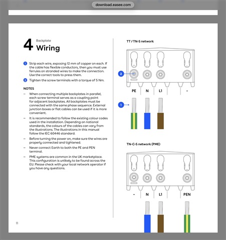

  • The wiring diagram in an Easee electric vehicle charging point instruction manual, which earth terminal should be used with a TN-C-S (PNB) earthing system?
  • download.easee.com/.../EN_One_IG.pdf
  • Try figure 13 and 14 here: https://commercial.nationalgrid.co.uk/downloads-view-reciteme/63784 (on page 53)
