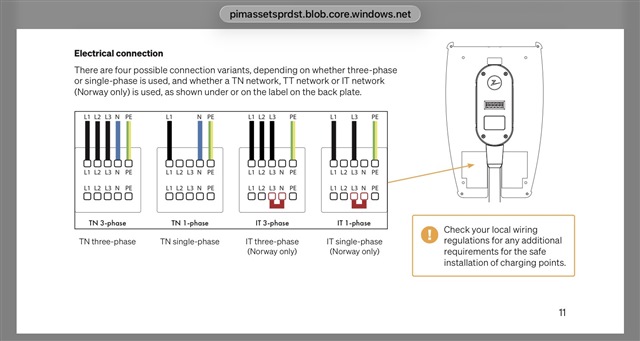

  • Above I referred to the installation instructions for EVSE made in Norway, which has a choice of two earth terminals for TT/TN-S or alternatively TN-C-S.

    IT (Isolated Terra) is found in approximately 75 per cent of in Norway, and consists of either 1-phase (2 conductors) or 3-phase (3 conductors) plus earth (PE). There is 230V between each of the conductors and the neutral point of the transformer is not earthed, but is protected with a spark gap between neutral point and earth. Thus, there is no so-called zero conductor. To convert from IT to TN, a transformer must be used.
    TN (Terra neutral) is used in almost all of Europe, and around 25 per cent of Norwegian electricity subscribers have this. TN consists of four conductors (three phase conductors and one neutral conductor) plus earth (PE). This means that you can extract 230V between each of each phase conductor and neutral conductor, and you get 400V between each phase conductor.
    www.elbilgrossisten.no/.../ladeguiden-valg-ladestasjon
  • Which then gives some interesting wiring instructions for the Norwegian Zaptec EVSE.
    pimassetsprdst.blob.core.windows.net/.../27109439.pdf

  • Wow since when did the simple act of earthing get so complicated! I don't think it was always so  things really need simplifying. Any how that first picture can't be a real installation surely if the supply people left me with something like that ide be very dis chuffed. In my road we have earthing to the outer lead sheath of the PÌLC cable except for in a recently rewired flat  above a shop which has PME ie the neutral and earth are joined in the meter cabinet, also the earth is joined to the water pipe and the gas pipe so fairly standard. The water pipe is metallic all the way down to the ground.  So what would you call the overall system? There are at least two places where they've added a copper rod laid in the ground and tied to neutral. So is it PME PNB TNS or what. I found by chance that I can get a continuity reading between earth and neutral  there's no link in my supply so it's a bit of an odd one.
