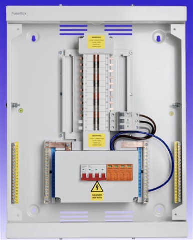

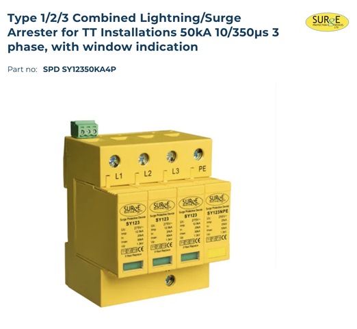

If you have a three-phase distribution board with a four pole three-phase SPD preinstalled by the manufacturer and then install a linking kit to convert the three-phase board to single-phase you end up with three SPDs in parallel on the same phase.
Is that potentially an issue?
www.tlc-direct.co.uk/.../FBTPN03FBX.html
