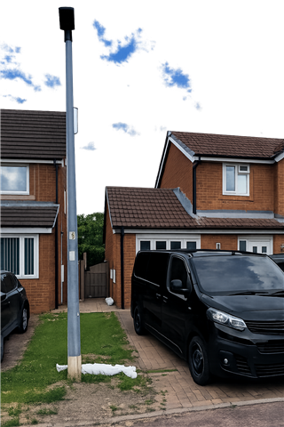

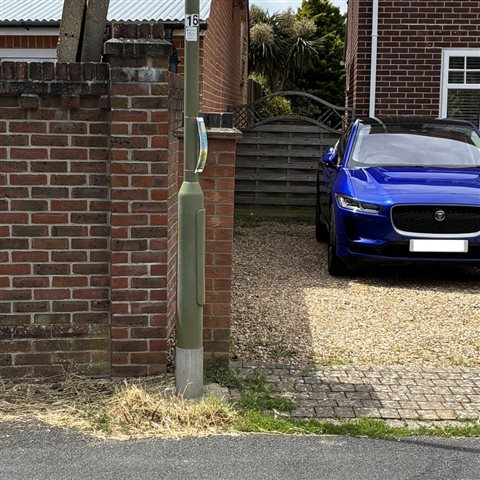

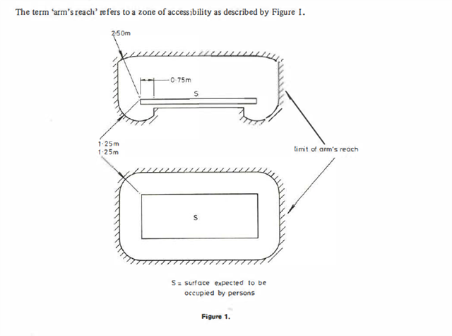

I am seeking the collective views of the group regarding the issues we are currently encountering within the EV installation environment in relation to simultaneous contact.
In simple terms, we are seeing a significant number of installations where customers have lamp posts located within their driveways. In many of these cases, it is not possible to achieve the recommended 2.5‑metre separation distance.
My position is that, where physical separation cannot be achieved, the application of layered protection at the EV charge point and associated switchgear would leave the customer in no worse position than prior to the installation. It is accepted that the proposal only outlines protection on the vehicle, but there are no other solutions for industry, are we with the protection detailed taking enough measures to carry out an install and in affect leave the install without a subsantial increase in risk?
My proposed approach to managing simultaneous contact risk would follow a structured hierarchy as set out below:
  • Can the maximum separation distance be achieved?
  • Can barriers or enclosures be installed to prevent simultaneous contact?
  • If neither of the above options are achievable, can layered protection provide an acceptable level of risk mitigation?
With layered protection, the proposed measures would include:
  • Installation of a compliant open‑PEN (O‑PEN) protective device
  • Provision of a double‑pole 30 mA Type A RCBO
  • Use of a charge point - M3 21 mA protection
Based on the above, the assumption is that, if all protective measures are correctly installed and verified, the installation would incorporate:
  • Automatic disconnection within the required times
  • Residual current protection
  • Open‑PEN fault detection
This combination of protections would significantly reduce the likelihood of a fault condition persisting for any meaningful duration.
On this basis, the key question for consideration is:
Where physical separation and barriers are not achievable, would it be considered acceptable to proceed with installation relying on this layered protection approach?

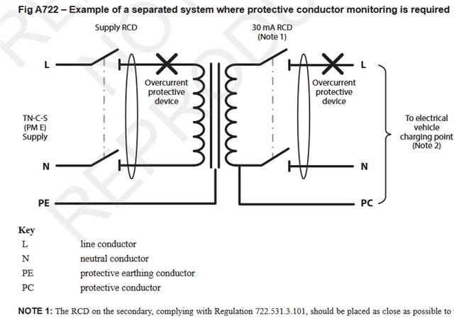

  • Just out of curiosity, does anyone know of any instances at all of option 722.413 being used for real? (i.e. use of electrical separation to supply EVSE - e.g. as per fig A722).
  • It is unclear why the PC exists as it looks like an opportunity for fortuitious earthing which is the opposite of what we want here.
    It'll be because the EV power protocols check for the presence of an working earth connection before allowing charging to commence. Without the PC (and N-PC link) the EVSE/car would refuse to play at all.
     For full fault protection you probably want both the two pole RCD drawn and a three pole RCD encompassing L, N and PC between the two pole RCD and the transformer / N--PC link.
    In what situation would the 3-pole RCD "see" any imbalance? (given the N point isn't earthed)
  • You need the PC (it connects to car metalwork) to N loop to be detected as low impedance for the car to decide it is safe to charge. (some cars struggle on TT supplies with a high electrode resistance)
    There is also a pulsed DC signal/ pilot line between car and charger that uses the PC as its return and reference voltage.

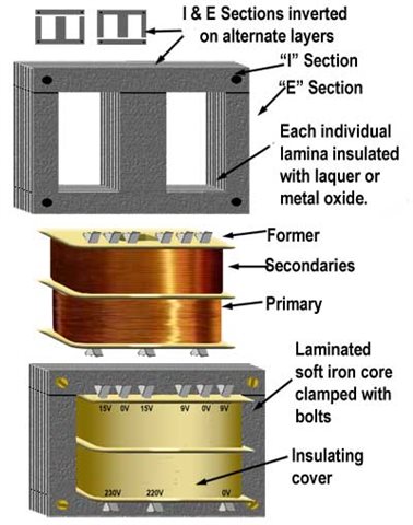

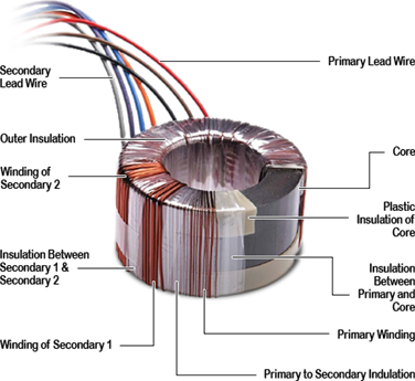

  • Probably not much change from a cube of side 40cm and a weight of ~ 75kg by the time you add the windings and the enclosure.
    Not a bad guess! - e.g. https://www.farnell.com/datasheets/3744957.pdf
    Toroidal ones seen to come in at about half the weight though - e.g. https://www.victronenergy.com/upload/documents/Isolation_Transformer_8000W/108939-Isolation_transformers-pdf-en.pdf
    It's not clear whether either actually meet BS EN 61558-2-4 though and even those make the charge point itself look sensibly priced.
  • For full fault protection you probably want both the two pole RCD drawn and a three pole RCD encompassing L, N and PC between the two pole RCD and the transformer / N--PC link.
    No, definitely not a 3-pole device.
    The PC is required to do two things:
    (a) As others have said, permit EVSE (charging points) and EVs that incorporate protective conductor monitoring to actually permit charging; and
    (b) As the EV is Class I equipment, and EVSE may be, or incorporate, Class I equipment, it is absolutely needed to permit the RCD to operate for a fault between a live conductor and an exposed-cponductive-part given (a).
    This type of system, with protective conductors connected to a live conductor, and possible Earth (but not necessarily) is used quite frequently with temporary generating sets, and is described in BS 7430:2026 as 'IN-S'.
    The RCD located immediately after the source, with the live conductor to PC referencing point on the source-side of the RCD, is absolutely vital for safety, to prevent a very nasty surprise, if the live conductor not referenced to the PC becomes accidentally Earthed (say if a cable is partially damaged).
  • No, definitely not a 3-pole device.
    The PC is required for two reasons.
    First, as others have said, it allows EVSEs and EVs with protective conductor monitoring to recognise a valid protective conductor and permit charging.
    Second, because the EV is Class I equipment, and the EVSE may also be, or incorporate, Class I equipment, the PC is needed to allow the RCD to operate for a fault between a live conductor and an exposed-conductive-part.
    This sort of arrangement, with protective conductors connected to a live conductor and possibly to Earth, but not necessarily so, is used quite often with temporary generating sets. It is described in BS 7430:2026 as “IN-S”.
    The RCD immediately after the source is absolutely vital, with the live-conductor-to-PC referencing point on the source side of that RCD. Otherwise there is a real risk of a nasty surprise if the live conductor that is not referenced to PC becomes accidentally earthed, for example through a partially damaged cable.

  • It would still need proper earthing strategy
    Or rather unearthed strategy - the whole point being to avoid the problems from (differing) earth references. Separated systems (and variants such as IN-S) are well known and long recognised by wiring regs - as well as portable generators you can look at shaver sockets (and other situations where one item of current using equipment is used) section 413 of BS 7671, similar to multiple items (418.3), unearthed supplies (including by transformer fed from the grid supply & a  N-PC link feature) in mobile and transportable situations (section 717) and of course the specific situation here - in section 722.
    Nothing involving LV electricity is ever entirely risk-free (especially in 2nd fault or double fault from single event situations)- the damaged flex on conductive soil is a classic risk even in conventional ADS systems - the usual mitigation being the addition of a 30mA RCD. Sections 722 and 717 take exactly the same approach where the separated installation extends outdoors.

  • Toroidal ones seen to come in at about half the weight
    Well toroids have windings around almost 100 % of the magnetic material , but conventional cores with a  centre leg and 2 sides only wind on the centre, the outer leg close the magnetic path but are outside the windings.
    so the wound section is representing sightly less than half the iron, hence the doubling of weight  - and also the halving of inrush. Toroids are smaller but  are really bad at burning switch contacts unless there is a soft start circuit and also something of a cow to wind. The machines are fun to watch ;-) Transformer solutions at the multi kW  power level are not in the domestically normal category the main customers are DNOs, and they want something bigger, and that lack of a market  is reflected in the price.
