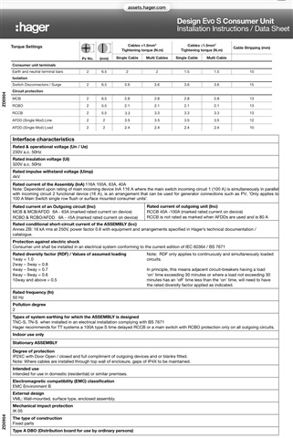

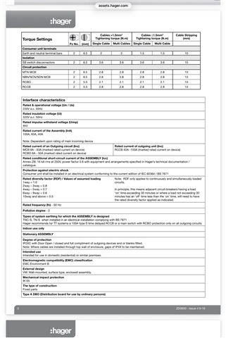

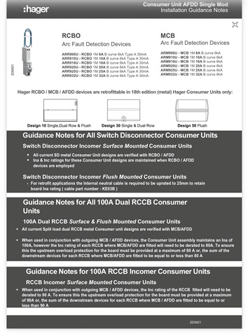

  • Condition a. of 536.4.202 requires that In of the upstream device is less than or equal to the rated current of the assembly (InA) and any outgoing unit (Inc). As I read it, this condition will not be satisfied by a consumer unit, with a rated current of 100 A and protected by a 80 A supplier's fuse, if, as is likely, it contains outgoing devices with a rating of less than 100 A; a 6 A RCBO for example.
    Surely this cannot be the intent of the wording; or am I misunderstanding something?
  • or, more correctly, ... outgoing devices with a rating of less than 80 A.
  • On further reflection I suppose the outgoing circuit may not always contain a further protective device, in which the wording does make sense.
  • This applies to more than just a distribution board. So the assembly could be a series of switches, each of whose current rating is less than the assembly as a whole. The incoming protective device would need to have a lower rating than the lowest rated switch, otherwise it would not be protected.
    I cannot think of an example in a consumer unit.
  • Indeed, I was being a little blinkered in my thinking Chris.
  • I cannot think of an example in a consumer unit.
    80A (or even 63A) MCCBs in a split-load 100A CU?
