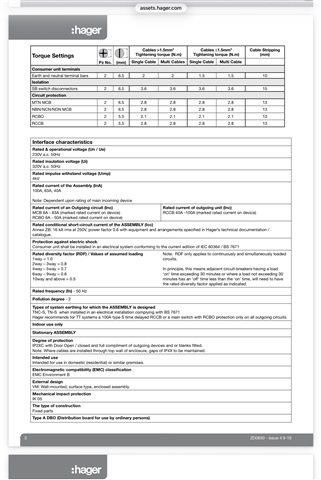

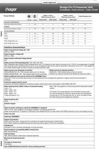

When reading this new clause, it appears to apply to all switchgear, which means diversity can no longer be used in the design of electrical distribution switch / control gear assemblies.
I am aware of the necessity, where multiple sources of supply are connected in parallel, to ensure main switchgear / distribution boards are sized for the sum of supply capacities, but the above new clause does not reference multiple sources of supplies.
Could i get the communities thoughts on this new clause please?
