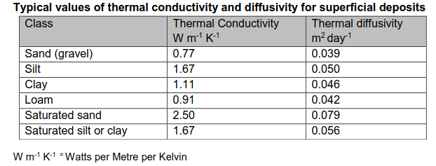

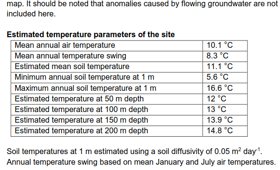

For buried cables, the soil thermal resistivity and ground ambient temperature are required to be able to calculate the CCC of the buried cable.
The Regs states 2.5 K.m/W and 20 °C respectively but with the caveat that other values may be used either where measured or the ERA figures can be used.
Table 4A2 shows example drawings of buried cable which appear to show the cable buried direct in the soil with no indication of sand/pea gravel bedding, cover etc. (How many installations just dig a trench, drop the cable in then just backfill with the soil that's been dug out with no bedding/cover?)
Chapter 16 of the Commentary on the Regs states that the 2.5 K.m/W value is "conservative" and that "...BS 7769-3-1 (IEC 60287-3-2) provides standard conditions for the UK as follows:" and lists 1.2 K.m/W and 15 °C.
1. Why doesn't the Regs use the "standard conditions for the UK"?
2. Where does sand/pea gravel bedding/cover come into this, or is the "conservative" 2.5 K.m/W meant to cover such but it just isn't mentioned anywhere?

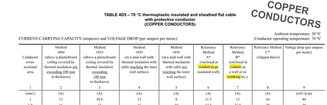

  • e.g. indoors adding capping or putting a cable into a conduit seems not to require a change in reference method
    Agreed where the capping/conduit is embedded in plaster (and probably no change in installation method needed, see explanation under Reference Method C in 7.1 of Appendix 4 in BS 7671) but not in general, for example:
