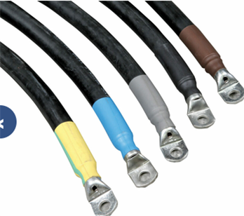

    A couple of stripes on the lug and over the sleeving at each end and anywhere part way where you cannot see the end, that you could perhaps cut into the wrong cable .

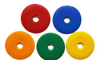

    Discs are more normally used to indicate phasing and are very commonly seen nailed to the wooden back board beside a domestic intake fuse, and are essentially a coloured plastic washer like one of these. Can be cable tied to the cable.
    modern ones are self adhesive and
    also have a letter for the colour blind.

    PS if you were installing from scratch, large heatshrink can look nice
