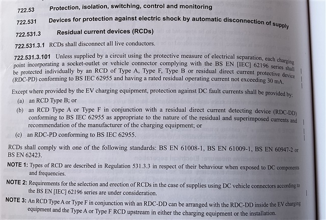

    A leading and well respected member of this forum commented on LinkedIn that although electricians can choose to use either the brown third amendment book or the orange fourth amendment book up until the 15th October 2026 for new installations and alterations to existing installations, all EICRs should be prepared using the orange amendment four book, because they have to be prepared to the latest available edition and amendment of The Wiring Regulations BS 7671:2018:Amendment 4:2026.
    There are several minor amendments in the orange book to 722.531.3.101 as identified by the lines in the right hand margin.
  • But as I read it,nothing in there prohibits and additional RCD upstream shared with other circuits (if that's what we have here). Not exactly ideal design perhaps to have two 30mA devices but lack of selectivity is hardly a C2.

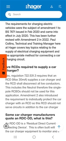

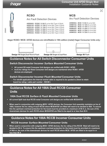

  • Throw in typical manufacturers guidance from the time of installation such as this from Hager.
    "Amendment 2 also introduced the requirement to individually protect the car charger with an RCD so this RCD should not serve circuits in addition to the car charger".
    hager.com/.../ev-charging-and-rcds
    "Amendment 2 also introduced the requirement to individually protect the car charger with an RCD so this RCD should not serve circuits in addition to the car charger". "This RCD may be also supplying other circuits within the house which could then be affected or in some cases blinded by any DC that may be coming from the car. These other circuits then may not have any residual current protection, the consequences of which could be severe.".
  • This RCD may be also supplying other circuits within the house which could then be affected or in some cases blinded by any DC that may be coming from the car. These other circuits then may not have any residual current protection,
    Hence my questions about whether the EVSE contained its own RCD (most do these days I gather), whether CU RCD was an AC or A types and whether the EVSE provided 6mA d.c. protection.
    Charging point is to be 'individually protected' (722.531.3.101) ... but, provided the upstream RCD is of an appropriate 'Type' (i.e. Type A or Type F unless there is no DC residual current protection in the EVSE) then is it actually 'potentially dangerous' (there just being a 'selectivity' issue)?
