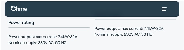

  • Who installs 7.4 kW EVSEs? I though the maximum standard rating was 7.2 kW.
  • Hi,
    As per my comment in the "Electricians in the real world" thread my understanding is that AC EV charging is a constant current load, not constant power.
    I suspect that since the EV load is 32A then the argument will be that with the added load of the EVSE itself (a whole 25mA?) plus the fact that it is suboptimal to run domestic MCBs continuously at their rating, a 40A MCB / RCBO is the better choice.
  • Hi
    EVSE is switchgear, not a load.  Providing you are operating it within its voltage rating then usually the interesting parameter for switchgear is its current rating.  We don't rate CUs in kW so I'm not sure why we do that for EVSE.
  • As per my comment in the "Electricians in the real world" thread my understanding is that AC EV charging is a constant current load, not constant power.
    Yes, that is also my understanding. If correct, it needs someone to respond on the DPC form.
  • Interesting point. However a lot of the regs try to take a 'simplified view' [rather than a let's over complicate this view], which leaves many making assumptions about how loads are to be assessed.
    Plus, as you say, the EVSE isn't a load, but the EV behind it is a load, and the confusion is over the way the wiring to the EVSE should be selected and spec'd, especially when others keep following the 'loads are in kW' primary expectation...

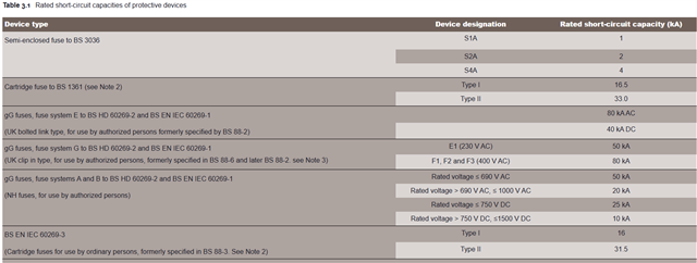

    Not necessarily - it's still permitted to handle overload and faults separately - if the EVSE provides overload protection, the cable still need only be sized for 32A provided it's c.s.a. has enough withstand for the B40 fault clearance (54000 A²s for a 6kA device - or just over 2mm² Cu for k=115). (double check the c.p.c. though if T&E)
