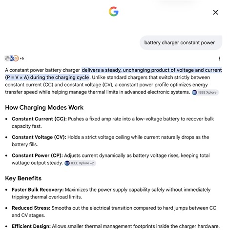

  • I asked Google about “battery charger constant power”
  • Yes, the EVSE signals the maximum available current to the EV using the Control Pilot pin in the charging cable, the EVSE can then operate upto that limit, as required.
    That current limit signal, depending on the EVSE hardware and the installation, can be used very simply as a fixed limit, or it can be varied dynamically to provide smart charging functionality, to manage the load at the house, or on a circuit, or to control charging to track the output from solar generation to self-consume solar, or for smart charging with time of use tariff.
