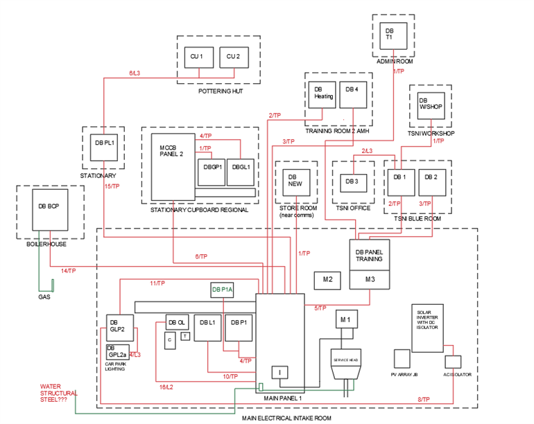

  • What about appending a bit of a sketch. We do this for every periodic inspection that has multiple boards.
    Presumably, for a significant installation, the designer will have provided sufficient information for the constructor to install as intended, so there should be diagrams available for an EIC.
    Certainly, 514.9 requires that the information be provided. I suppose that the buck stops with the last person involved, i.e. the inspector.
