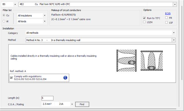

However, when selecting an XLPE Flat Twin & Earth cable (90°C thermosetting), ElectricalOM identifies the cable against Table 4E2. The software also provides an option to “Run to 70°C”. When this is selected, and Reference Method A No. 3 is selected, it gives a current-carrying capacity of 21 A for 2.5 mm².
My question is therefore whether this is an appropriate application of Reference Method A No. 3 for XLPE Twin & Earth installed within a thermally insulated stud wall.
In particular, where the installation is not relying on the 90°C operating temperature of the XLPE cable, is it permissible to use the 4E2 installation/reference-method arrangement but limit the conductor operating temperature to 70°C, resulting in the 21 A rating?

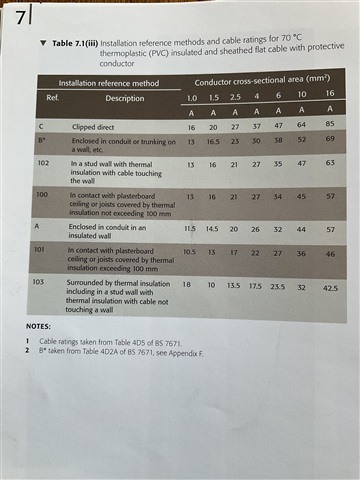

  • Reference Method A is in a conduit in a thermally insulating wall. It is NOT equivalent to Method 103# ... they are two different columns in Table 4D5.
    So, for 2.5 sq mm in Table 4D5, Reference Method A I get 20 A ... this seems to be very similar to the 21 A Electrical OM is giving you.
    So, I don't think you're comparing like-for-like.
    Are you installing the cable in a conduit in the wall, or not? If not, then you can't use Reference Method A you selected in Electrical OM ...
  • Hi thanks for your reply.
    yes i am currently not showing it in conduit, and i have used Reference A No. 3 - multicore cable as indicated, and not Ref. 103, as this is for PVC t&E.
    and within Elec OM this shows me this cable type is from 4E2 table, and when i put it as "In a thermally insulating wall" Method A No. 3 - it is giving me 21A for a 2.5mm cable:

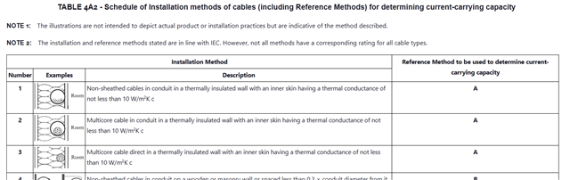

  • Note also the caveats - in all the higher current thermal approximations the cable is not supposed to be totally surrounded by insulation, but is expected to be able to cool by contact with and/or close proximity to one or other of the partition surfaces.
    10W/m2.K is equivalent to only 1cm of material of Thermal Conductivity 0.1 (W/m·K) (say like a sheet of plywood or plasterboard). Considering that Glass fibre or Celotex are at least  twice if not three times as insulating as this, you only need a 3-5mm layer of insulation on the supposedly cold side of the cable to use up all of that cold-side thermal resistance allowance -  for cooling out into partition wall, so now the wall surface itself needs to be aluminium or copper  to only just remain within specs.  Smile

  • My issue is that people are taking the 4D5 derating table Reference 103 and showing this as only 13.5Amps.
    That's because it's a different situation - 103 is for a cable totally surrounded by thermal insulation - Method 3 (ref Method A) is for a cable in contact with the plasterboard one side and so is only partly covered with thermal insulation.
    If you cable is totally surrounded by insulation the 103 is correct - and if you're using 4D2 you'd probably need method C plus a correction factor for the insulation (likely 0.5) - e.g. 27 * 0.5 = 13.5 (see reg 523.9).
    If your cable is only partly surrounded by insulation and can loose heat through the plasterboard, then Method A would be correct, which would correspond to method 102 (rather than 103) in table 4D5.
