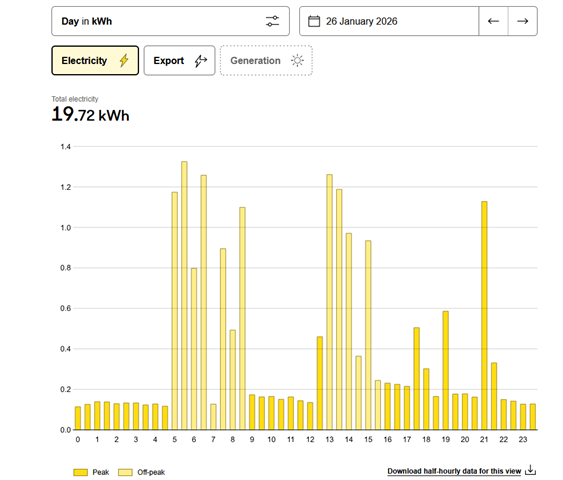

    I put in a heatpump to replace the ageing gas boiler about a year ago, so we're "all electric" now (other than not having an EV yet) - cooking is all electric and the gas has been disconnected. Even on the worst day I can find data for (Jan 26th) we used less than 20kWh with the highest half-hour reading of 1.3kWh - so less than 12A over that half hour- and that level only lasted a couple of hours - the average over the day is still below 4A.
    The place is pretty well insulated & airtight though - which probably makes a significant difference - but that's the sort of thing that can be replicated elsewhere if people have a mind to.
    Adding in say another 7kWh a day for an EV - if it could be spread sensibly between other loads - could still work. After all 27kWh over 24 hours is still below 5A average.
