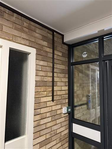

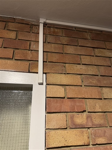

Dear Engineering folk,
To enable new fire doors to be installed in 60 flats, across 5 buildings, some entry system cabling is currently penetrating existing door frames, so has to be moved.
The surface cabling is surface mounted in mini-trunking in the common hallways.
Two main questions:
  1. Can the existing cable be removed from the door frame and re-drill new cable penetrations into the brick wall, to connect the handsets, avoiding the new certified door frames?  Photograph 1 and 2.

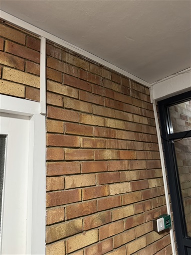

  2. There are other buildings with recently installed call units, using surface mounted mini-trunking (brown) and wall penetrations - is this allowed?  Photograph 3.
If the above is not permissible, what should be done instead and can you point me at the appropriate regulation?
One building has a gsm entry call unit, so no cables, which is probably ideal, although owners seem reluctant to change from fixed wired units with video and audio.
Apologies, I do not have copies of the regulations, as I am not an electrical expert.
Many thanks,
Mark

  • regs wise there is nothing magical about interlock wiring. It should either follow a visible route (trunking, conduit and even surface clipped in areas of low risk are all examples of that) or if concealed under a wall surface, follow a vertical or horizontal line between fittings, or be deep enough (50mm say) not to be casually damaged by decorating or later building work work (shelves and notice boards). Or in the ceiling wall corner is considered a 'safe zone.
    Drilling a hole through brick is fine, far better than damaging the frame, I'd expect the hole to be cleaned and mastic (normal or firestop depending on location ) to stop insects and draughts, a short length of plastic tube to protect it or guide it through a cavity wall may be appropriate, this is most important if the cable jacket is soft and may be scuffed. If the change of direction is too sharp then a box can be fitted on one or both sides of the hole.
    Cables that are overhead, must be secured so as not to fall in a fire - so if there is plastic trunking stuck on a ceiling , you may need some builders band or metal clips that would stop hot sticky cable garotting someone trying to escape, and folk worry about plastic wall plugs, and like to avoid them if possible.
    That's about it ;-)
    Mike
