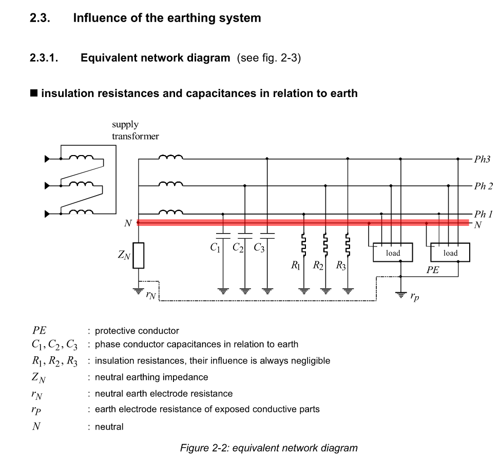

For High resistance earthed, LV systems, Can the neutral be used like this? Will there be any safety issues like increase voltage in the neutral?
It is certainly done, and is a half-way house from TNx to the fully floating supply (IT) situation,. There are a couple of advantages in terms of fault currents being reduced, and everyone knowing how much earth leakage there is while in use (from the neutral to CPC voltage) . Earth bonding diverted currents are lower, as are the chances of an imposed shock voltage on things like outside taps or neighbours plumbing and gas pipes
But,like IT the insulation, and perhaps test , requirements need to be stricter - in the event of a hard fault to ground on say phase 1, during the time it takes ADS to pick up, the other two phases are at 415V to ground, and the neutral is a 240 to ground, Correctly wired loads don't care, its a situation similar to the wild leg 3 phase in the US, the voltages between the wires remain correct.
But, those of us used to assuming that neutral is at or near earth potential, and that includes designer of CUs with unshrouded neutral rails, might be set up for a failure.
The resistor itself needs to be extremely robust, as it only ever get shock loads, and must work at least as reliably as the RCDs, ideally more so.
But yes, its very much a thing in parts of the world where the ground is a poor conductor, or nearer to home, like the London Underground DC traction, where the power is maintained against a first fault, to allow trains to be limped out of tunnels. I have been told In the old days the traction supplies were earthed at the centre tap of two lamps, and an earth fault on one line meant that sides status light went out, and the other lit up extra bright, but power could be kept on if required, and the fault current was only that of the filament lamp, and unlikely to start a fire.
Mike
As Mike says, but to add that BS 7671 does "strongly recommend" that the N is not distributed in IT systems (NOTE to 411.6.1) ... although not prohibited,
I disagree it's a 'hybrid' ... IT systems can be impedance-earthed. So can TN systems if the impedance is low enough to permit timeous operation of the appropriate protective devices providing fault protection for ADS (which since BS 7671:2008 clearly includes RCDs), or to satisfy the formula for additional protection by supplementary protective equipotential bonding.
Effectively, there is a 'sufficiently high' impedance where a TN system actually becomes an IT system, see Regulations 411.6.1 and 411.6.2. Until that point, it is still a TN system.
If it crosses the threshold into an IT system, then agreed, BS 7671 recommends the neutral is not distributed in polyphase systems.
