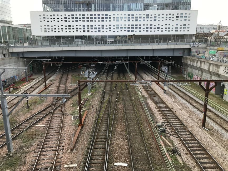

For over 30 years, investment has flowed into urban regeneration of the River Seine south bank (“rive gauche”) in eastern Paris. Most visible is the iconic Bibliothèque François Mitterrand (French national library) constructed in 1995 right on the riverside. Running just behind this building and parallel with the river is the railway approach to the Austerlitz main line train station. To create a neighbourhood better connected to the river, the architects and planners decided on a radical solution: construction of buildings directly over the top of the railway.
Picture: Approach to Paris Austerlitz station before construction started (mirr.eu)

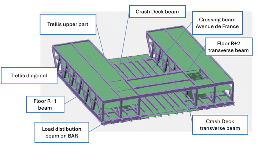

The whole building sits on 50-meter steel beams over the train tracks creating a 50-meter “bridge”. The beams are installed on spring bearings to supress vibrations from the trains moving underneath. The first two levels are formed by a steel trellis frame mounted on the beams providing open space for shops. The 10 floors of apartments are built in timber on top of the trellis frames. This offers a unique selling point for the apartments and reduces weight. The lift and stair shafts are built in concrete.
Diagram: Diagram showing the trellis structures mounted on the beams traversing the railway (mirr.eu)

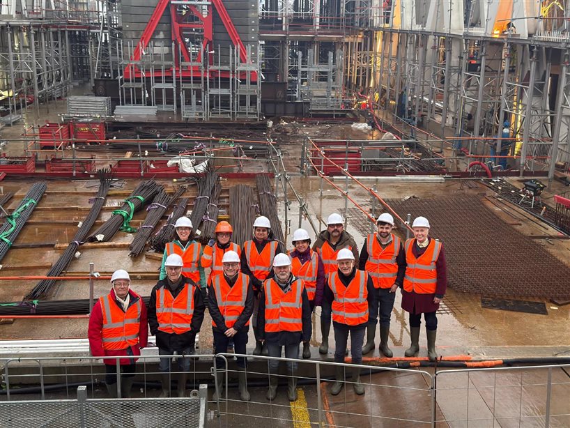

At the time of the visit, the entire bridge section and steel trellis structure had been completed. Only concreting of the floors within the trellis structure remained to be done. Construction on the wooden apartment frames was already underway. This allowed us to see all the construction methods and discuss some of the many innovative and challenging aspects of the project. This included deploying concrete and steel combinations that approach the strength used on nuclear power stations. The architecture is designed to appear light and open while giving a high-class aesthetic finish. This is not always easy as the construction is effectively a set of bridges themselves build on a 50m bridge!

Picture: ICE and IET members at the T6B site
