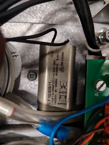

As above really can any one give an idea on the testing of this filter to confirm if faulty, never come across this type of filter,
There was a gel type substance on the damaged one which caused some skin irritation but I want to prove it is faulty electrically ,

  • Basically to summarise why we are suspecting this may be short , is that we had to replace the main PCB which then had the magic smoke appear and everything on the secondary side of the board was then shorted down to earth, we are suspecting this may have caused it however not 100% certain the replacement PCB was new. So just process of elimination now before we fit another and hopefully doesn't happen again
  • yes - actually if you are not too worried about EMC you can probably test the downstream load without it, and you can certainly test it with something else as load.
    The circuit on your box should be interpreted as below, with the end with the word 'drossel' at the left, and it looks like the left hand CX may be omitted - if so it stops interference from  going in but not so much from coming out....
    Your pair of exit wires at the other end are P' and N' on this diagram. They may cross over in the box, it does not alter the operation and the meter will tell you. The earth "PE" and PE' are the mounting lugs.
    So from P to P' should be low resistance, verifying L (top winding)
    From N to N' the same, verifying L lower winding. Between P,N and PE high resistance - possible Rx between P and N, expect hundreds of k ohms or more. Or while its out on the bench you could put mains in on P N & E and connect any load you don't care about (workshop lamps or small heater perhaps) to P'N'E' and see that all works as it should.
    At 50Hz and DC the coil windings are small and can be treated as a short length of wire, because really they are, but  they do take time to respond to very fast changing currents and this will 'choke' the faster transient currents . Similarly at mains frequencies and below the capacitors are just an insulator between conductors - hence the symbol, but on a microsecond timescale that insulator can store and release charge, briefly holding the voltage up or down from sudden dips and peaks. Any surge or dip lasting more than a microsecond or two and the filter that size is not going to be able to do a lot.

  • There is a 2.2M resistor between the lines. So an insulation test may read lower than usual.
  • Ah yes sorry, the value is actually in the photo, so yes, expect a couple of megohms +/- 20% on the phase to neutral resistance reading. 20% as no cost-effective manufacturer would use anything tighter toleranced if it cost them more, and these seem to be "value engineered" units if they are omitting the left hand capacitor cluster.

  • So my findings so far
    Short end p-n 0Mohm on each end
    p-p 0ohms
    N- 0ohms
    N-Pe 0.1Mohm
    P-pe 0.1mohm
    What do you think to these readings I think this is a broken filter
  • Apologies p or n to pe is 100Mohm
  • Short end p-n 0Mohm on each end -
    If I understand you right, that means live is shorted to neutral internally and you have an educational paper weight...
    Do not try to use it.
  • Yeh so just to clarify testing on the short ends (not across the the filter) I get that 0Mohm reading on insulation resistance , this would make sense why the PCB burnt out too with a dead short across a L/N
  • this would make sense why the PCB burnt out too with a dead short across a L/N
    Is the PCB upstream or downstream of the filter?
