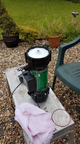

  • Shower pump end cap o rings are what I had in mind.
    A mechanical service kit is over fifty quid, but the only way to buy the o rings as OEM spares
    Otherwise it’s measure and order for a second visit unless you know what sizes you are likely to want and carry stock with you.
    The comment I have seen is that if the stored hot water temperature is too high eventually the hot end O ring will shrink and a leak will develop.
    This pump is probably around fifteen years old and works fine apart from the leaking O ring. I don't have a vernier caliper rule to measure the O ring  and the house is being sold, so the customer said get a new pump at a cost of £320 then call back to fit it to avoid any hassle with the purchasers of the house.
    If there was more time and the customer was not selling the house I would considered measuring the O ring and ordering some online or calling st the bearings wholesaler next to the electrical wholesaler I use.
    A couple of quid to get some O rings plus some Nylock nuts versus fifty quid for a service kit or three hundred and twenty quid for a new pump.
    It comes down to how long you can reasonably extend the life of a fifteen year old pump and at what cost with customers expectations to be considered as well, you could fix the O ring leak only for something else to go wrong.
    I bedded the O ring back in with some silicone grease and tightened the end plate down in sequence, but it still leaked.
    I was considering if a O ring kit on the van could give a quick fix with one visit.
    Andy
