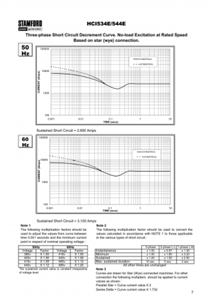

I am looking to specify a temporary mobile diesel generator and as such looking into the disconnection times and the maximum fault current provided by the genset.

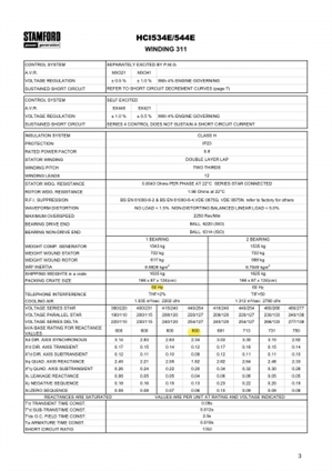

I have contacted a provider and got the specification of the alternator in their genset, images below of the fault current graph and the alternator per unit values.
I am looking into understanding what values to use. Am I correct in getting the sustained fault level and for an earth fault to apply the multiplication factor of 2.5 for sustained? I will make sure my disconnection times are less than the sustained maximum duration in order to not trip the generator breaker and loose all of the supply.

  • Unlike the street supply the output of a genset is a reactive impedance, and also a function of the state of load at the time of measurement. As a result, attempts to measure Zs in the normal way fail.
    To allow calculation, the wiggly curve is expressed as if it were a stair case with square corners, and flat regions.
    The results are given as multipliers, called by Cummins and others 'per unit factors' . So for example a genset configured for 100A, with a multiplier of 0.1, will supply 1000A into a dead short, until something changes.
    Typical multiplier values for gensets of some 100s of kVA or so are
    Sub-transient reactance X"d  0.09 – 0.17  First  6 cycles or so -determines maximum instantaneous current  and used for rating 'instant' breakers.
    Transient reactance X'd   0.13 – 0.20 6 cycles to 5 sec. current for short time delay circuit breakers.
    Synchronous reactance Xd 1.7 – 3.3 any time after 5 sec. This is the voltage droop, if there was no regulator to wind up the field and increase the torque and demand more fuel  i.e. woudl be the current without excitation support. In reality, the genset controller kicks in on this timescale.
    The Q factors are for  a step change in reactive load, and more use for determining the phase of the transients, and load steps for reactive loads.
    Your design current is 600kVA, 3 phase so I assume about 850A per phase L at full load.
    An LLL fault would heat the point of junction as if it was 2.5 times that.
    Your X'' d is 0.09. so an 11 fold multiplier into a dead short L-N , say 10kA , and then some more for luck, typically 2 for the worst case moment in the cycle to apply the short, as this gives an asymmetric transient.
    Your PSSC for rating your breakers could be 20kA.
    Is an LLL fault credible in your system ? If it is I'd consider checking if there are 'death or glory' fuses inside the genset.  three 1kA fuses would never go in normal operation, but would allow lower rated equipment downstream.
    However, what ADS is in the genset ? I'd expect the first item to limit the duration and let-through energy so that smaller (perhaps10kA) breakers can be used downstream.
    edit some background reading attached as an app note from Cummins.

    Thanks for the explanation. My the confusion arises from the values and the graph.
    The steady state curve shows a 2700A 3- phase fault. if I use the reactance values shown the values are not consistent.
    Steady state 2700A -> For a LN fault x2.5 -> 2700 X 2.5 = 6750A
    Zero sequence reactance is 7% for A 600kVA unit. This gives around 11.9kA
    Am I missing something?

    On a 600kVA set, isn't your steady state around 800A - and as a first approximation of dividing by X"d of 0.09, would give you a fault current of around 8.8kA for a short duration (ie within the clearance time of the CPD)
    Which isn't that far away from Mike "multiply by 10" values (as you'd imagine) - for earth fault you really need to consider the use of symmetrical components and you'll require the zero sequence reactance of the machine.

  • Mike and OMS,
    I appreciate your values calculated and the fact that the full load current itself is pretty high, small MCBs will trip. What i am trying to do though is as everyone use Amtech. The Amtech platform has a set value for the generator fault level. As from the alternator manufacturer the fault curve is relatively flat towards the steady state I wanted to use this figure. I am sure this level will trip almost all devices despite that the installation is a 60+ yers old station with at least 4 levels of circuit breakers.
    What i found odd is that the calculated fault levels from the provided impedance per unit values do not really reflect the curve values. This is what I would like to understand.
    Thanks,
    Mike

  • Thanks Dave and perspicacious, your responses seem reasonable to be honest, the table with the fault multipliers though has a time limit per fault type and for that I assumed that the time durations and levels corresponded to the alternator actually been driven by that diesel engine.
    Thanks
    Mike

    If I've read the graph correctly, the set will provide just 2000 A at 0.1 sec. Will the preceding higher current be enough to operate the primary protective device and/or how far downstream?

    The main risk here is loss of supply on a main circuit supplied by the Micrologics in the case of insufficient fault current downstream of those breakers. Which eventually leads us to this whole story on the discrepancy of the fault graph and the per unit values. I also note that the per unit values provided have a time constant associated with them the sub-transient and transient values seem to not be useful as they are very fast.
