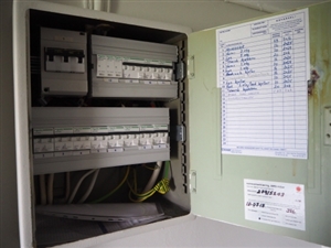

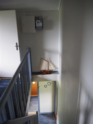

Following on from my piece on Swiss domestic wiring I took a few pictures of the installation in a rented house in North Norway. The Meter and Distribution Panal are mounted over the stairwell. Both appear to have been fairly recently upgraded. The supply is 3 phase via overhead lines.
There is a 63A main switch, surge protection devices and lots of RCBOs

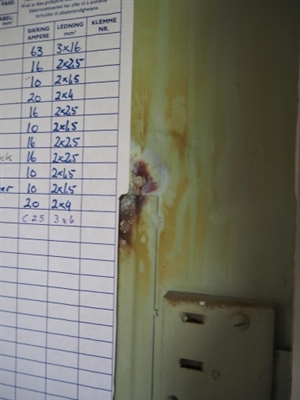

There looks to have been an interesting event in the past.

  • It appears that an electrician will be positioned between a rock and a fall if working on the fuse box. Or is it just the camera angle causing that assumption?
    Z.

  • Are they still on an IT earthing system out there?
    Curious that some of the RCBOs are 15A rather than 16A rating - I didn't think that 15A was one of the preferred ratings these days.
  • I'm surprised that for domestic use there isn't a separate front lid and front cover. I could imagine that if the lighting circuit tripped, someone might open the door and blindly feel around inside, touching all sorts of things they shouldn't.
  • Interesting they've used 4.0mm for the 20A circuits, here 2.5 would be order of the day?

  • Thank you all for your interest. I don't know much about Norway's system but here are a few answers that I can give:
    The meter is completely over the stairwell. The distribution panel is reasonably accessable from the landing.

  • I see the numbered labels are all about to fall off.
