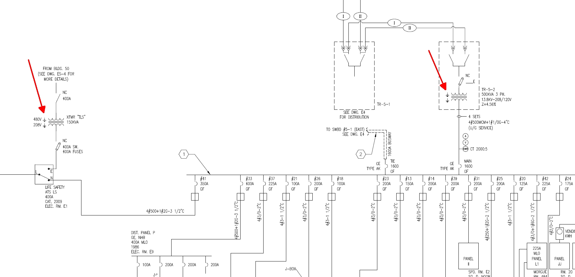

    From my view point I don't see multiple parelled sets of 4/0 PE breaking at once. Considering all the PME supplies...
    Is "4/0" a reference to AWG? About 100mm²?
    Perhaps not, but I don't think there's anything in the digram that suggests the size of the system or that conductors are to be paralleled - it could just as easily be applied to a small system - say a domestic off-grid setup with multiple sources where perhaps something closer to single 1.5mm² conductors might be the order of the day.
  • Attached files
    Actually your diagram is a little different to the one in BS 7671 (in appendix 9) - I'm guessing yours is the IEC original and the one in BS 7671 has been 'modified by committee'. Does yours have a title or description that refers to the Earthing system?
    The BS 7671 ones - both with a distributed N (Fig 9A) and without (9B) appear identical in earthing arrangements (TN-S to my eyes) but in BS 7671 9A is tagged TN-C-S and 9B TN.  I wouldn't have put it passed the UK committee/typesetters to have got things confused - they seem to have replaced the note/key references (a) to (d) with (1) to (4) so they don't match the diagrams any more.
