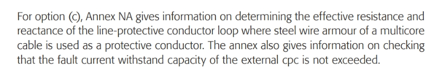

  • John,
    Makes sense, im assuming the choking effect is what is discussed in Annex NA (taken from GN8) as the screenshot attached. I cannot find this annex anyway, could you expand on what you mean of the choking effect - Is it that the higher resistance of the steel armouring will initially lower the fault current?
