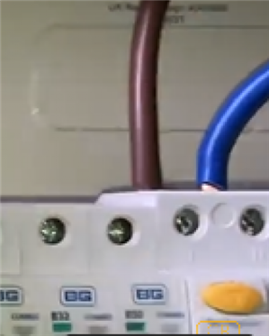

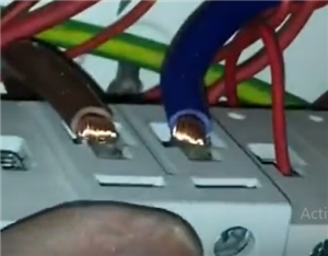

  • Nothing like pulling the main fuse and then posting the evidence on line! ?
  • Putting the SPD at the far end of the bus bar on the second RCD means that the circuits on the first RCD have effectively over a meter approx of cable path (L+N) between them and the SPD. It should really be put before the RCDs, next to the main switch.
    It's worse than that, putting it after a non-delayed 30mA RCD means that the RCD will likely nuiseance trip as soon as the SPD reacts to the first pulse - the 2nd pulse to come along then finds the SPD disconnected, but half the installation on the other RCD still connected - but now completely unprotected.
    If you do have to put and SPD downstream of an RCD it should be at least an S-type (as per note to reg 534.4.7).
    I completely agree!

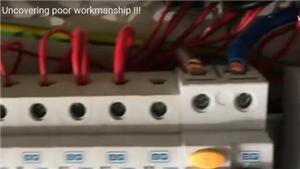

  • It would appear the installation was put in to service without main protective bonding see Regulation 641.1. But the bonding was installed the next day so that's alright then?
    How comes the neutral earth problem was not discovered during the dead testing process rather than energising and tripping the RCD? Or is this a version of the 230V bang test?
    Should I mention the absence of a circuit chart, an RCD label, a Mixed colour label and a periodic label or am I being fussy?
  • John Peckham:
    I thought that at first John, looked again and it seems he reconnected the old bonding to the gas overnight. Then upgraded it and added the water bond the next day. There were a few pipes in the old cylinder cupboard which also dive into the floor, I assume flow, return and hot water which could introduce earth potential and might have needed to be bonded.
    Dead tests were done before the old board was removed apparently  "gonna do some tests on these rings and stuff, see if they got continuity and stuff".
    edit; Although we suspect the installation was energised overnight and the clients were home, we don't know that for sure. Indeed the fact that the RCD tripping occurred the next day suggests it wasn't energised overnight.
