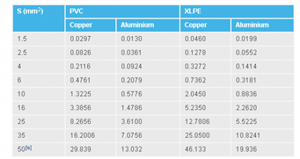

  • I guess the thing I'm not getting is, if there was a L-E short at the cooker outlet then the (Sk)² of the 6mm² T&E's E conductor will be sufficient to withstand the I²t of the short circuit current, while if the the short was 2m further away at the far end of the flex 2.5mm² flex, Zs is not significantly higher, so I²t remains the same, while (Sk)² is much reduced and not sufficient. I feel I'm missing something very obvious here.
  • Are you sure it  is not enough ? Usually it is, the range of Zs for a far end fault for which the 2.5mmsq cable does not get too hot in the breaker trip time is quite wide.

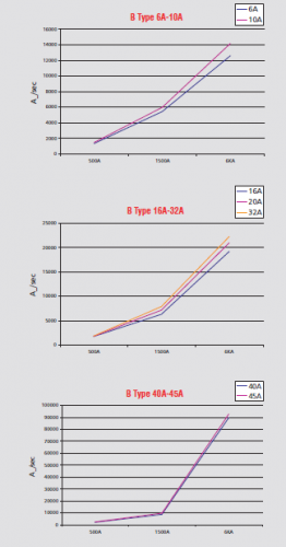

    For a period of 5 seconds or less, the relationship I2t = k2S2 characterizes the time in seconds during which a conductor of c.s.a. S (in mm 2) can be allowed to carry a current I, before its temperature reaches a level which would damage the surrounding insulation.  so for 2,5mmsq, say 0.08  x 106, l say 80 000
    allowable thermal stress for cables I2t (expressed in ampere2 x second x 106) so for a typical 40A breaker
    so any fault less than about 4kA, and high enough to take out the breaker fast, say 5* 40A plus 10% for luck, say any fault current in the range from  250A to 4000A  will be just  fine for  full fault protection for a 2.5mm cable on a B40.
